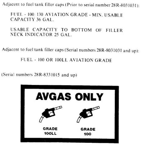

I have a Piper that holds 77 gallons total fuel capacity.  Of the 77 gallons only 72 are usable.  2 1/2 gallons on each tank are unusable.
Question:  If I only fill each tank up to the tabs, how many gallons do I have?

I have a Turbo Arrow III with the same tanks.  77 gallons total... 72 gallons usable... 25 gallons at the tabs (each side) so both sides at tabs = 50 gallons.
http://www.piperowner.org/components/com_agora/img/members/9210/mini_TABS.JPG
