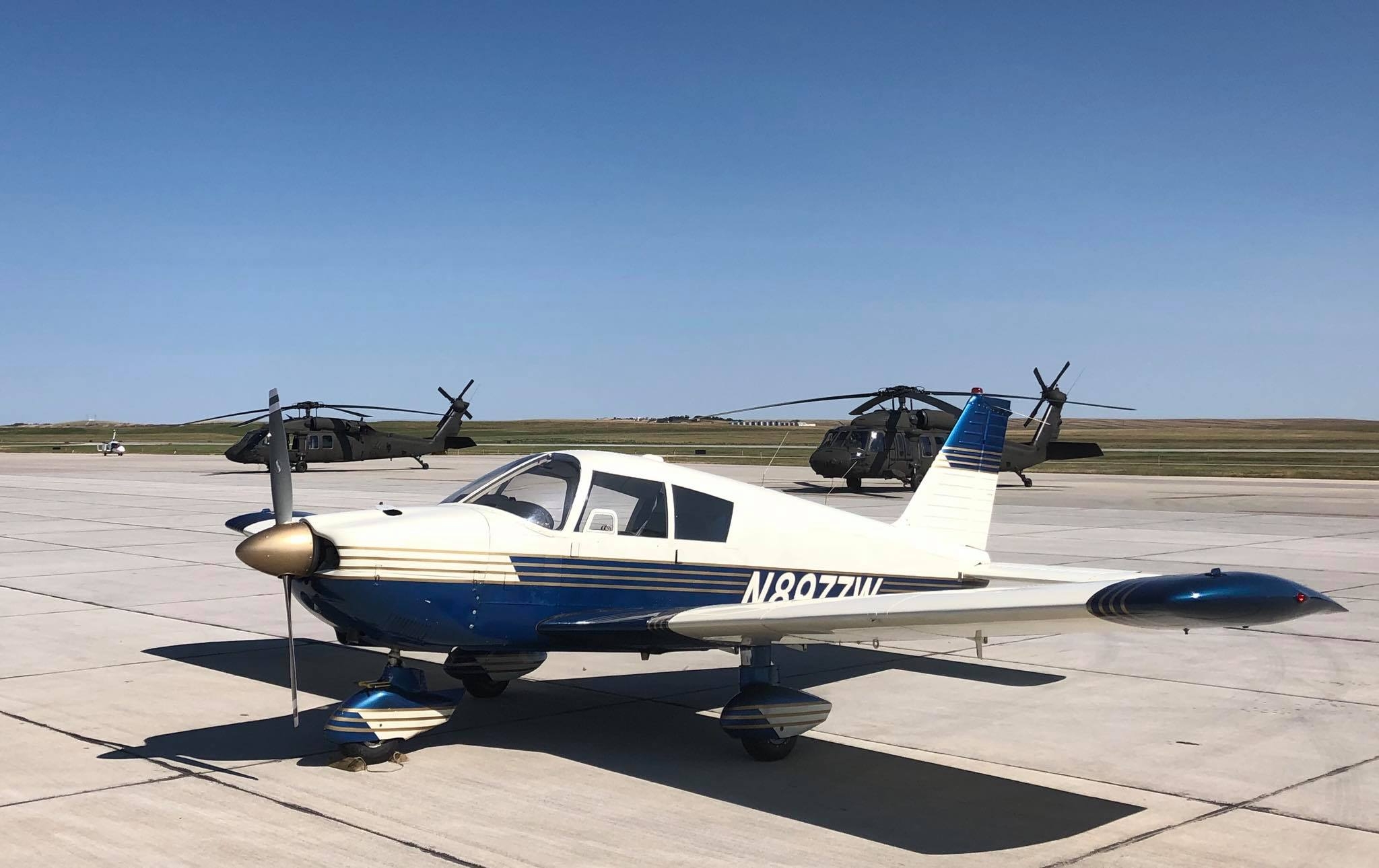

  • Here is a picture of the Rice rocket 235 Piper
    Lurch59
  • Nice looking airplane!

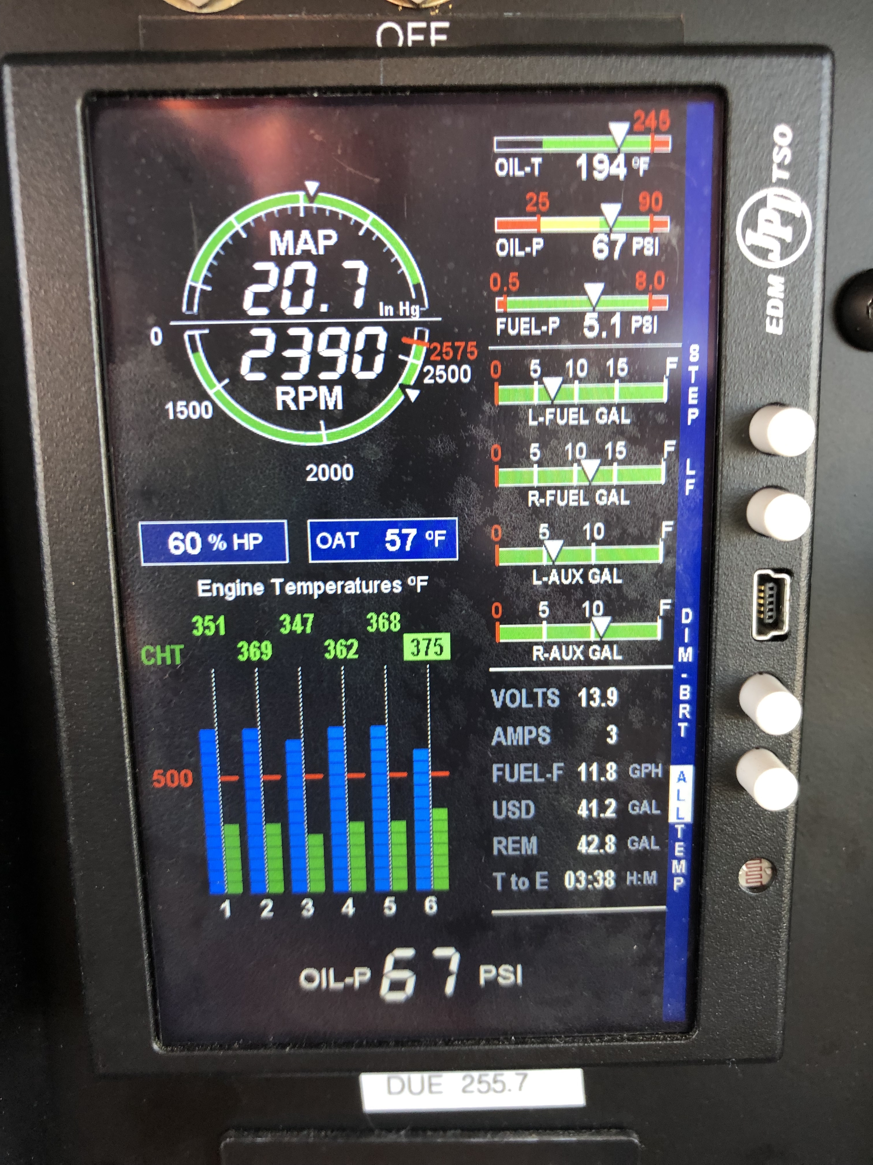

  • Here’s a snapshot of my 1968 235 with engine monitor running LOP. It took me a bit to figure it out since it’s carbureted and CHT temp spread can be more than an injected engine. I am able to get 132kts, 11.8gph, 375 hottest CHT (ROP I am 139kts and >16gph). The pearls are #1 fly high, above 8,000. #2 consider adding minimal (maybe 10-20%) carb heat which makes intake air more turbulent and can even out CHTs a little. #3 if CHTs a little high then pulling back even just a little MP (<0.5) can make a big difference in CHT. When leaning below 12gph listen and feel for engine toughness since you need to stay rich of that. All this requires good engine monitoring and would not attempt LOP in O-540 without it. Good luck with the upgrades and let me know your experience.
  • Now see, I don't understand why carbureted engines can't run LOP as long as all the cylinder head temps are not too hot. That is a significant savings of fuel, and the modern engine analyzers allow us to carefully monitor the temps. I fully realize I may be missing something here, so someone chime in and tell me where I am wrong.
