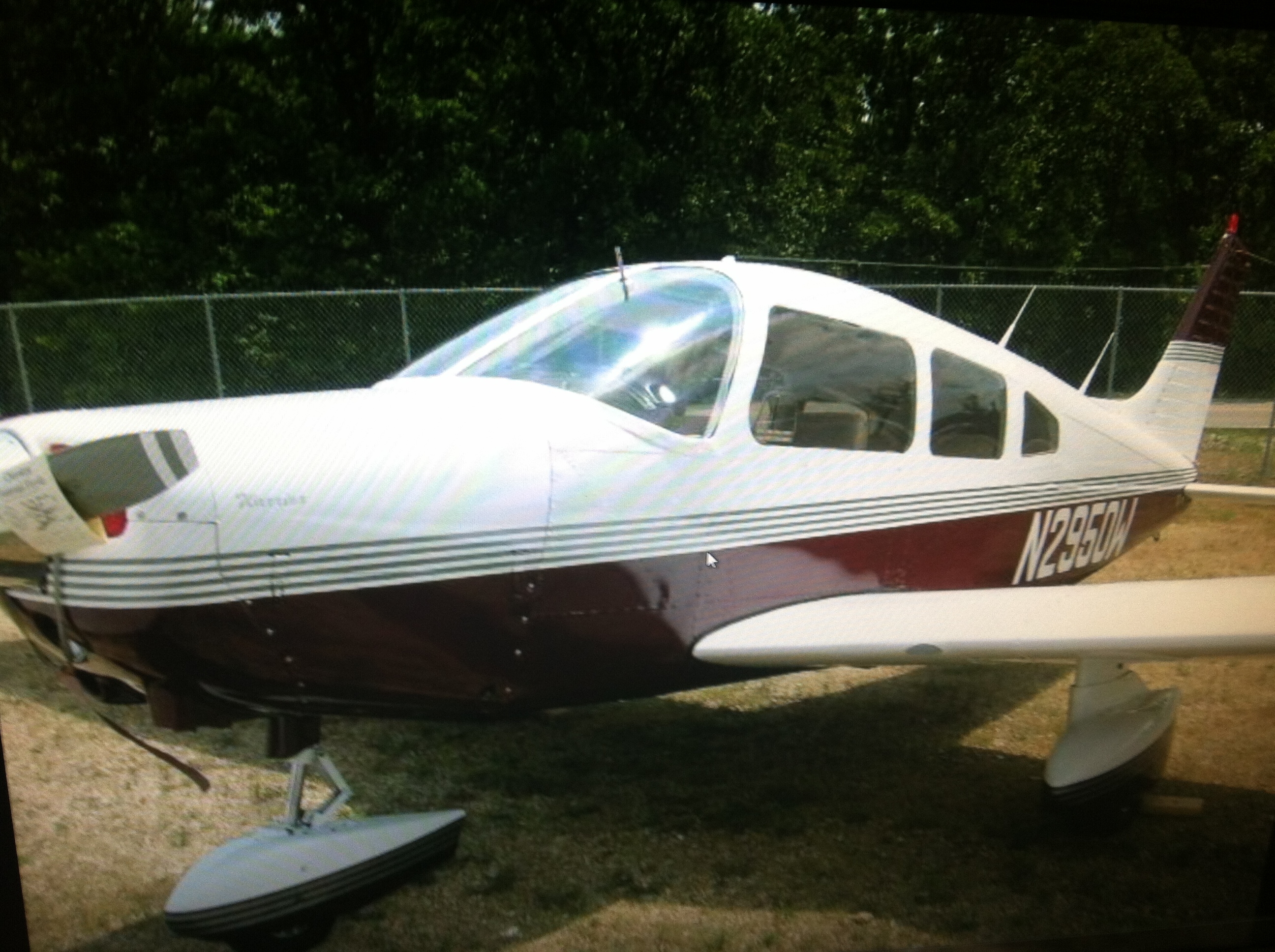

  • Here is the picture of my bird.

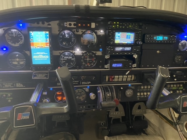

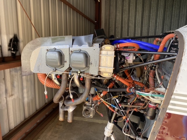

  • Hey checking back in with an update, got my new rebuilt engine from Lycoming a week ago. Engine has been hung on the mount with all new hardware. Taking my time on the assembly doing all the things I always wanted to fix. Also panel work is progressing well Aspen Pro Max is installed along with the new Garmin GNC-255A. Aerocruz 100 autopilot installation is in work. Shooting for the middle of August date to be ready to pull it out of the Hangar for Aspen Calibration.

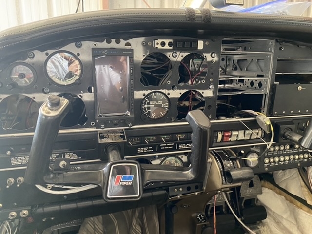

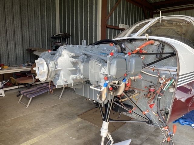

  • Seeing light at the end of the tunnel. Here is a few pictures of the progress.

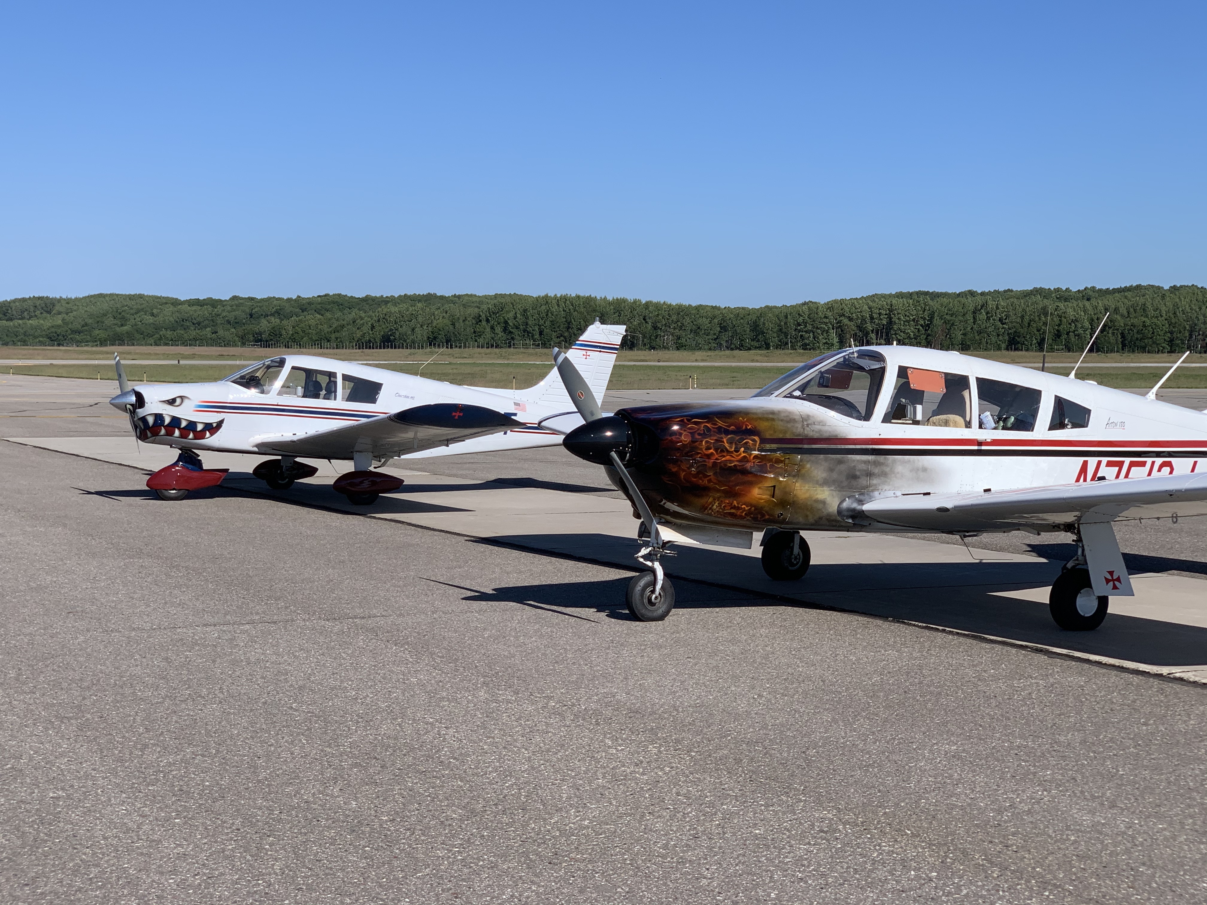

    I'm relatively new to the group and looking forward to learning more about Pipers. Been a Piper Pilot for awhile and my Honda Pilot is named...yeah.. Piper. I'm a maintenance coordinator for one of our flying club's Arrows. You can see pics of all the planes over here. (Though not all the club planes are Pipers.) And I'll upload one of our Arrows and an Archer.
