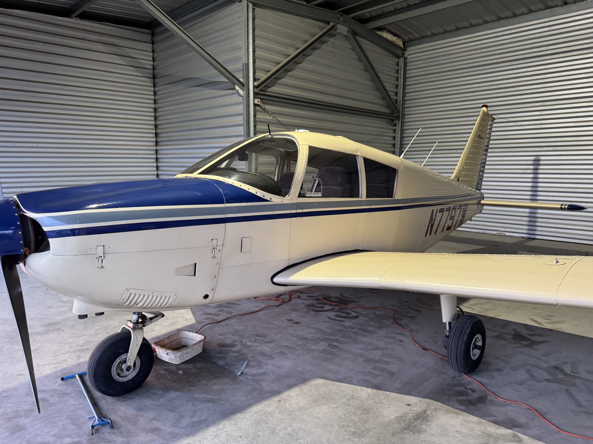

Officially joined the club with a 1964 Cherokee 180

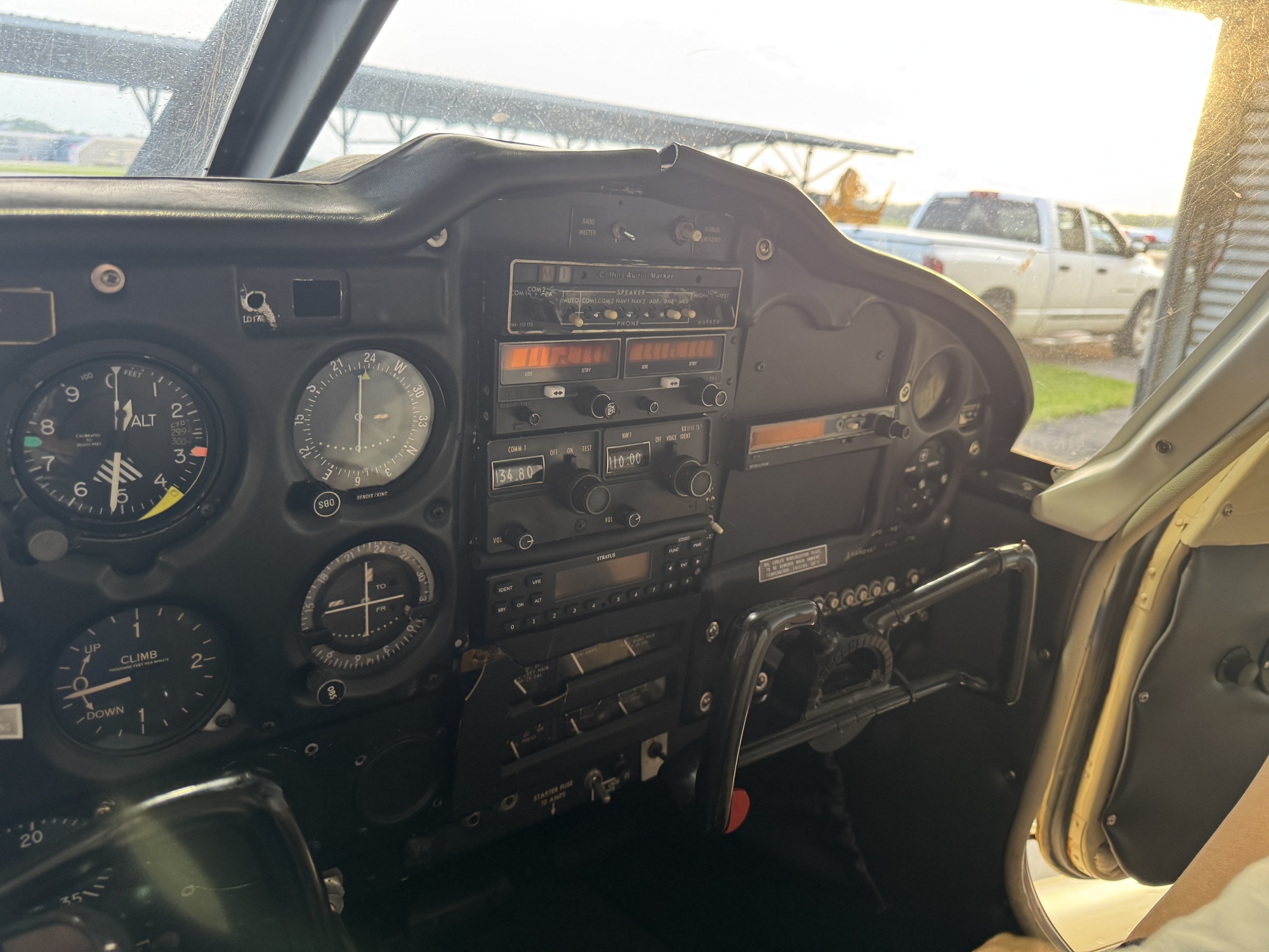

Pre-buy came back with minor gripes. Needed new tires and nose strut serviced, so seller knocked off $1500 but was sold with fresh annual and IFR certification. Also turned up some interesting avionics history. It has the servos for autopilot, it had a 430 at one time and then a KLN90 which prior owner reported smelling smoke coming from it so pulled the breaker and had it removed. Plan to use for CPL training and for my wife to get her PPL and do some cross country flying especially after she retires as well. Since it has fresh IFR cert I'm not going to do anything with the panel for a couple years. Want to get a good idea of what exactly I want and where.

  • The carb heat on is actually in the typed out checklist the prior owner made, he owned it for 22 years. I'm going through the POH now and making notes as the air speed indicator is in classic MPH with knots on the inner ring.
    It has all the mounting hardware for pants and must have at one time. No idea what's happened to them in the last 60 years as plane came pantless to prior owner in 2003.
    The IA that has worked on it the past 15 years said if I don't care about paint the flight school he works for has a set they are willing to sell for $400.
    Wife is going to be working on her PPL as well since we have planes would be a good idea to know how to land it in case of in-flight emergency. We're in good health, but ain't getting any younger. Although I also have an Ercoupe that she could learn to fly on...

  • The set the flight school had for sale are solid white. I went ahead and picked those up.I have no idea what my plane's base color is exactly other than "beige". Maybe it was mocha tan originally? I can't find anything in the logs about when the main airframe was last painted. However I do have the paint colors used when the after market wingtips were installed and the cowl painted in 2000, which is "Gondola Blue". So I guess if I want to burn some money I could get the pants painted that color to match the tips and cowl.
  • Finally found the paint entry in the logbook. It was painted "Chrysler San Mateo Wheat" in 1995. However the Sherwin-Williams Gondola Blue that the cowl & tips are painted in is still readily available so will probably have the pants panted that color eventually.
